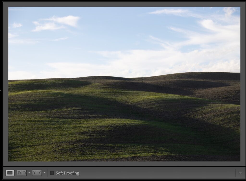

Above: Here’s the raw image out of the camera. Here’s a link to download the Raw image if you want to follow along:

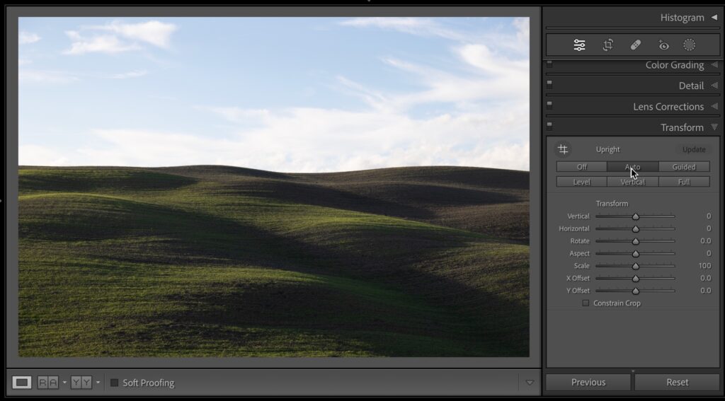

STEP ONE: The image is a little crooked, so head to the Transform panel (called the Geometry panel in the cloud version of Lightroom), and under ‘Unright,’ click on Auto (as seen here). By the way – you generally get better results from Upright if you first apply a Lens Profile in the Lens Correction panel (called the ‘Optics’ panel in LR cloud), but since the photo was taken with a mirrorless camera, it assigns the proper lens profile automatically for you).

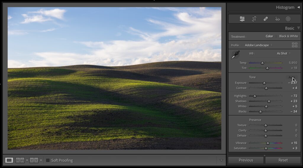

STEP THREE: Hit the ‘Auto’ button at the top right of the Tone section. It analyzes the photo and tones the image, and it generally does a pretty good job of at least giving you a decent starting place.

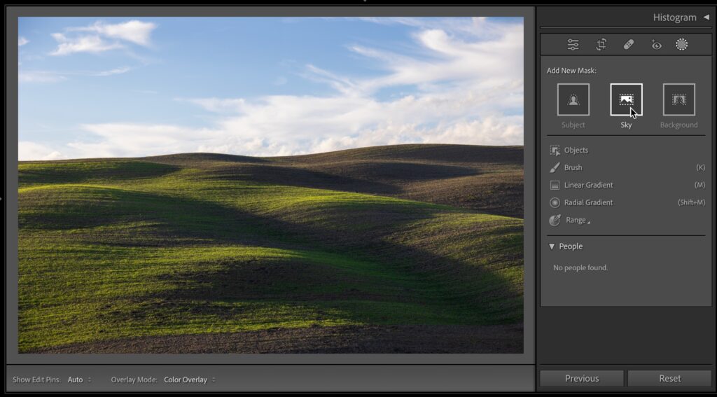

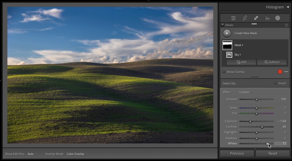

STEP FOUR: The Foreground looks okay, but the sky is kind of washed out. Click on the Mask icon (it’s the gray circle with the white dashed line around it), and when the Add New Mask panel appears, click on the ‘Sky’ button (as shown here) to select just the sky. The sky will appear in a red tint so you can see what it masked.

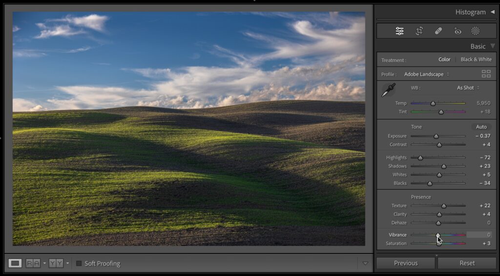

STEP FIVE: Now that the sky is selected, my go-to sky fix is to (a) lower the Exposure until the sky looks good, (b) Increase the Contrast so the dark parts of the sky get darker and bright parts get brighter, which makes the color looks more saturated, and (c) I increase the Whites amount quite a bit, so the clouds don’t look gray from the exposure being lowered so much.
STEP SIX: I finish things off by raising the Texture to bring out some detail in the foreground and bumping up the Clarity just a hair (more detail), and lastly, I lower the Vibrance amount added by the ‘Auto’ button earlier so the colors don’t look too bright (it’s mostly a problem with greens – they start to look neon-ish, so you could go to the HSR / Color panel and lower the Saturation of the yellows and greens, but this is just quicker and easier – as long as the sky still looks good after you lower the overall Vibrance).

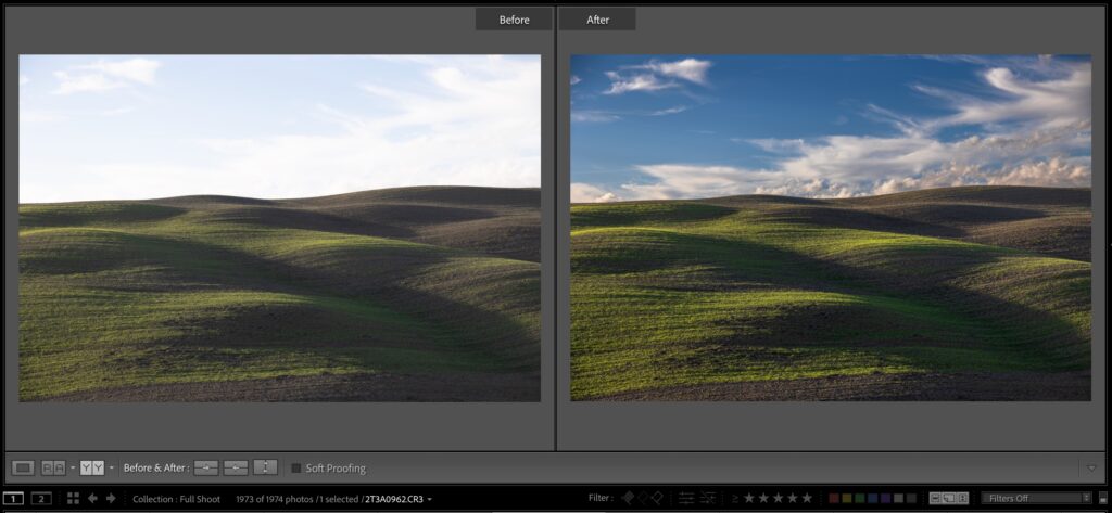

Above: Here’s a before/after (you just press the letter ‘y’ to see this side-by-side view. Press ‘y’ again to return to the normal view.
